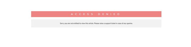

See the following for resolution:
https://softwaresupportsp.aveva.com/#/knowledgebase/details/000042799?lang=en_us
You need an account with a valid support contract to be able to access some parts of the support portal.
