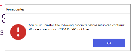

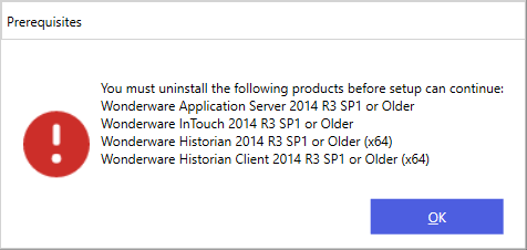

What would prevent 2023 R2 to install if I previously uninstalled 2014 R2 SP1 form the same machine. Total removal technote was followed
I uninstalled 2014 R2 SP1 from a View Client PC to install 2023 R2. The installation said I had to remove the previous installation.
I also followed the technote in manually uninstall 2014 R2 SP1, but that didn't help.
2023 R2 is still requesting to remove the prior installation.
Is there something specific that 2023 R2 is looking at to be removed before it would proceed to install
The OS is Windows 10
