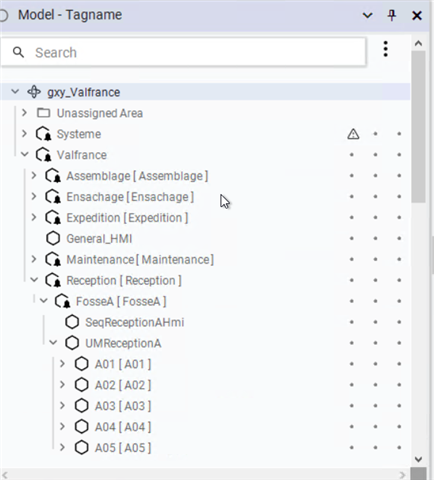

We have symbols linked to objects that display temporization parameters. Our customer wants a dashboard showing all temporization symbols for the deployed objects only.

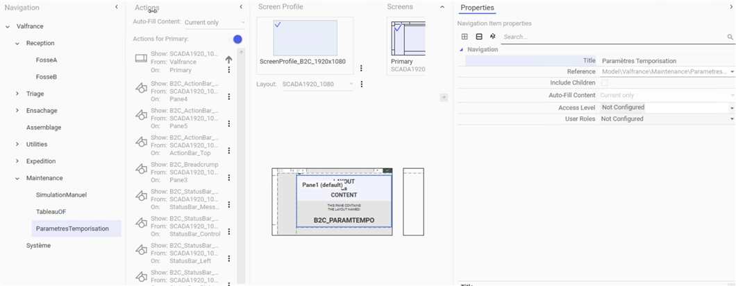

However, the ViewApp navigation doesn't show these objects when "include children" is selected. The ViewApp navigation stops at the area level.

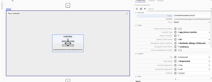

In the ViewApp navigation, we added a specific navigation node for the content presenter. However, it never shows the temporization symbols even if they are correctly set (content in the symbol and content presenter searching for this specific content).
We want the content presenter to search in the model view, not in the ViewApp navigation.
Is this possible? Adding the "_" in front of the alias name seems to stop the content presenter even if we selected "include children" from the area.
