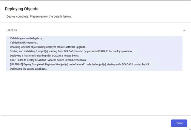

the error message in the deploy window is the following
Optimizing the galaxy database...
Validating connected galaxy...
Validating GRNodeInfo...
Checking whether objects being deployed require software upgrade...
Sorting and Validating 1 object(s) starting from SCADAS1 hosted by platform SCADAS1 for deploy operation
Deploying 1 Platform(s) starting with SCADAS1 hosted by HS
Error: Failed to deploy SCADAS1 : Access denied, invalid credentials
[WARNING] Deploy Completed: Deployed 0 object(s) out of a total 1 selected object(s) starting with SCADAS1 hosted by HS.

attachments: both support articles and 2x screenshots from log and deploy window IDE
