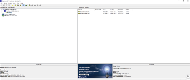

I was able to reach my production node from my plant node where I have the Matrikon application. The following picture is from my plant node, where I have the OPC

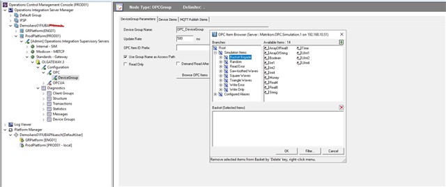

In my production node I'm able to see the tags of my OPC

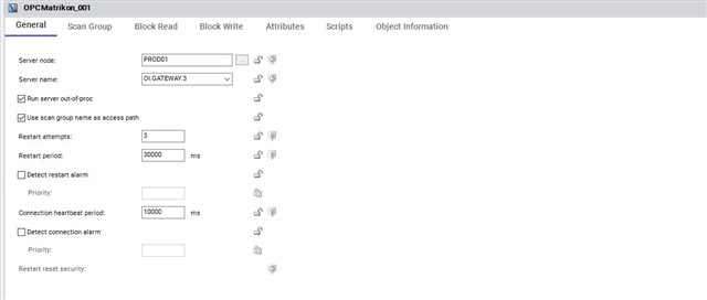

Finally when I go to my Engineering node, I'm unable to reach the tags, I can't see them. I tried writing its paths in a lot of different ways but nothing. Any idea on how to make this work?

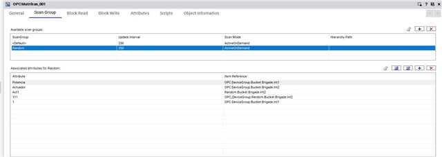

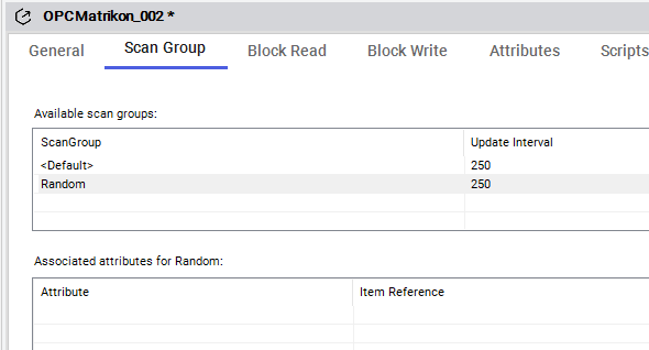

I tried with several associated attributes with a specific scan group, but nothing it doesn't seem to be the rigth path.
Any idea on why could this happen?

    I don't have the system in front of me right now and don't remember the syntax by hand, but you should be able to browse at least some system items from OI Gateway in the OPCClient object in Application Server. The browse button appears when adding a new alias with the + button.

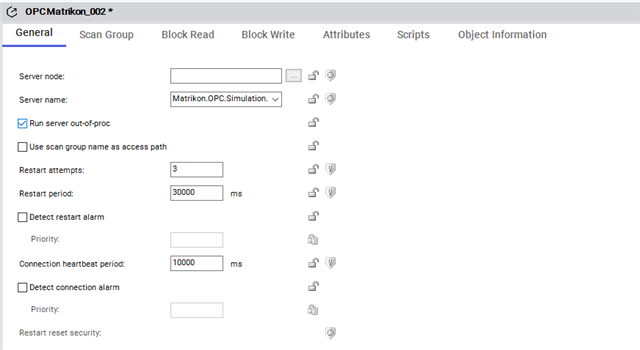

    If the Matrikon simulator is within reach of your engineering system, you may also connect the OPCClient directly to the Matrikon OPC server without having OI Gateway inbetween. If that is possible for you, it may simplify the architecture and you should be able to browse the Matrikon data model directly from the OPCClient object.

    But looking at your setup, the correct syntax for addressing on a remote object would be
    OPCMatrikon_001.Random.OPC.DeviceGroup.Random.Int1

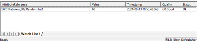

    Best way to verify is using object viewer.
    The use of Item references can be applied as a step 2, once you have verified connection, if needed.

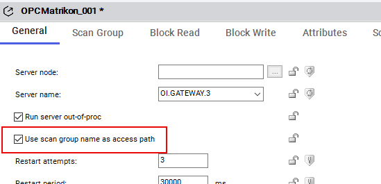

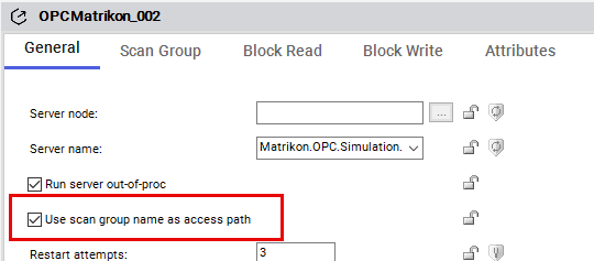

    I note that you have checked the Use scan group as access path, this would break the above address, since it will insert the scangroup name in your final address, on a incorrect position, this selection could be applied on other OPC servers, not OI Gateway, since OIGateway has the "OPC.DeviceGroup" in the access path.
    I would omit this selection for simplicity in your testing.
    If you would set up the OPC object against the Matrikon OPC server, without the OIGateway involved, the config would be simpler.
    Please note that I'm avoiding naming my scangroup to Random to make the following example more clear.
    Then your syntax would look the following: OPCMatrikon_002.Fast.Random.Int1
    <DeviceIntegrationObject>.<ScanGroup>.<Path.Item>
    In this case you could apply the Use scan group as access path method.
    Naming your Access name "Random" and removing one part of your address.
    Result would then be: OPCMatrikon_002.Random.Int1
    <DeviceIntegrationObject>.<ScanGroup/Path>.<Item>
