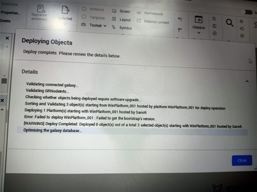

I'm trying to deploy viewapp from the application server to the runtime client server but i get error (Failed to deploy Winplatform_001 : Failed to get the bootstrap's version and when I open the OMI from the runtime client i cannot find any app?
1-I checked the bootstrap service and it's running
2-change network account and put the same domain and user
what can I do more to solve this issue ?

the GR platform already deployed before , when I deploy the platform i got this message
when i deploy the Client node platform i got this message
