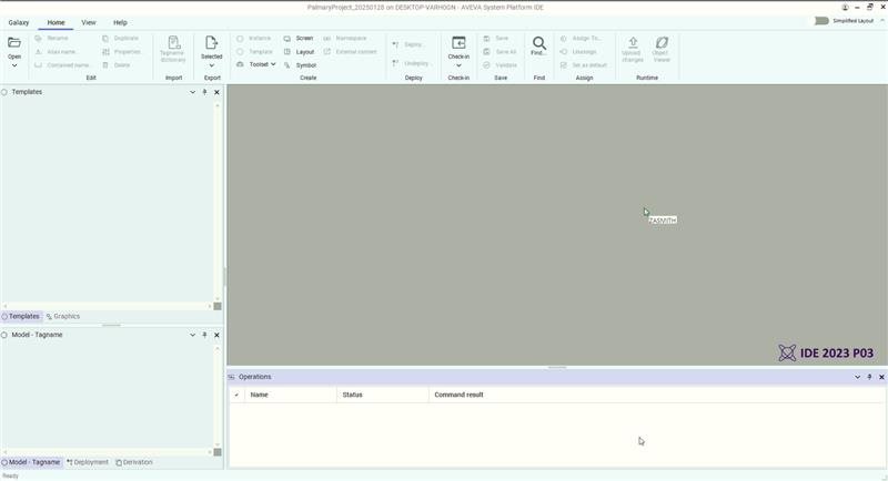

Hi, after installing the system platform IDE, restore has been marked successfully and when opening it shows empty tree view and empty template.
Attached pictures for more clarification,

  • First, Thank you for your answer,

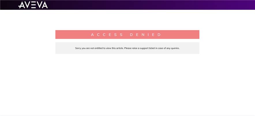

    the document is nor accessible,
    but I added sys admin role to NT AUTHORITY\SYSTEM and still have the same issue, tree view still empty and this for every galaxy, even for blank and demo that cames with the installation.
  • Ok, then your user account is not linked to a valid Support contract witch gives you access to Support resources on the support website.
    And I guess you are unable to review the following article too.
    https://softwaresupportsp.aveva.com/#/knowledgebase/details/000021642?lang=en_us
    Having a active support agreement is of value in such scenarios, especially if urgent assistance is needed.
