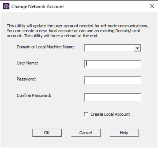

    • Ensure both GR and remote nodes have the same network account. Use the following utility to check or change the account
