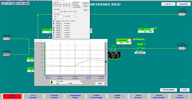

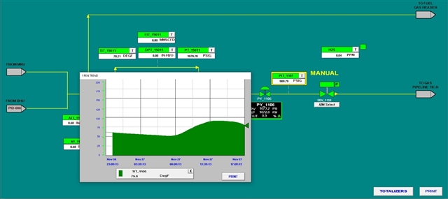

It shows data and historical trends very fine for short span. But if we set the graphs for longer span e.g more than 15 hour or 1 day span the trends automatically solidifies.
All the settings and scripting are the same as before.
No industrial graphics are being used.
Sample Pictures attached
Trend with longer span
Trend with short span

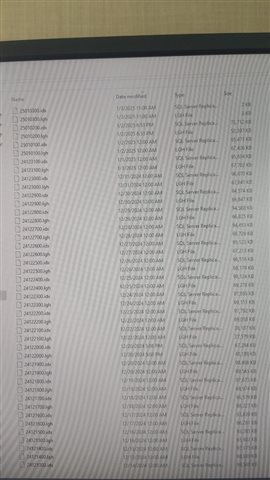

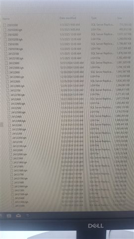

  • What is the resolution to address that .LGH file size issue?
    We recently noticed the same issue as well where our daily log file size increases from 2gb to 3gb in one of our upgraded system while the other System creates normal file sizes. (pictures attached).
    However, it was only few hundreds of MBs in older version.
