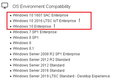

  • In compatibility matrix we see:
    +Windows 10 1607 SAC Enterprise+
    +Windows 10 2016 LTSC IoT Enterprise+
    +Windows 10 Enterprise+
    What abot Windows 10 Pro ?

  • I have read the link https://gcsresource.aveva.com/TechnologyMatrix/Report/Details?id=5927 and see the next list of operating systems:
    I'm planing to by computers by HP which has installed Windows Pro only..... If compatible OS is Enterprise I will need to buy computers with FreeDOS and buy Win10 Enterprise ....
  • We have Citect 2018 R2 running just fine on Win10 Pro on HP mini PCs.
