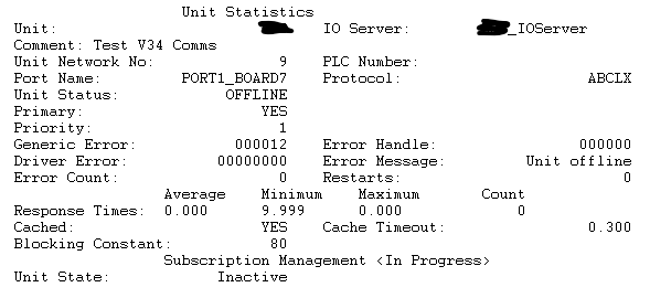

Hey Guys.
Has anyone successfully gotten the latest ABCLX driver inside of PlantSCADA to talk to an L8x series Processor running the V34 firmware?
Customer is demanding it. We've tested a project while talking to V33 firmware and everything is fine. Once we update, comms cease to exist.
My guess is Rockwell changed something and the ABCLX driver needs updated
Any ideas?
