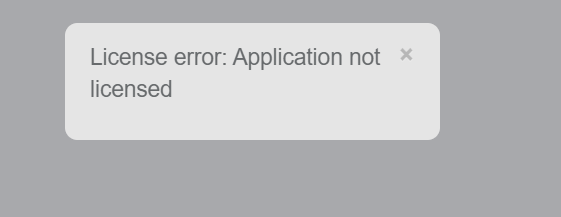

whenever i am trying to browse website First Login box open.
After entering correct details it shows  "License error: Application not licensed" . Does anyone know why ??

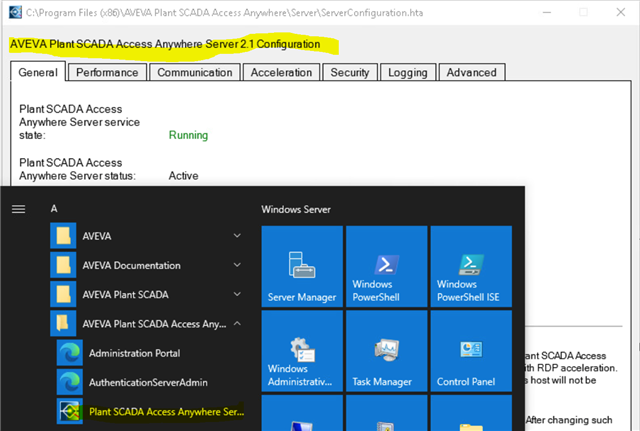

    Could you confirm the version of Access Anywhere being used? You can launch Access Anywhere Server Configuration from Windows Start-up Menu and check the version as shown in the screenshot below. According to the release notes, the license for Access Anywhere Application is no longer required from v2.0 (released for Plant SCADA 2020R2).

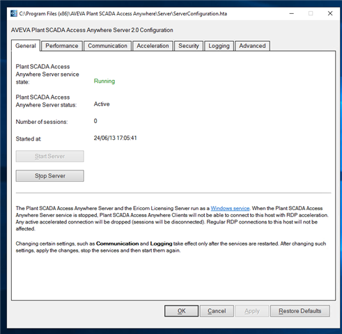

    • As you can see Access anywhere server Version is 2.0 .  Also Sufficient control client license are available in server.
