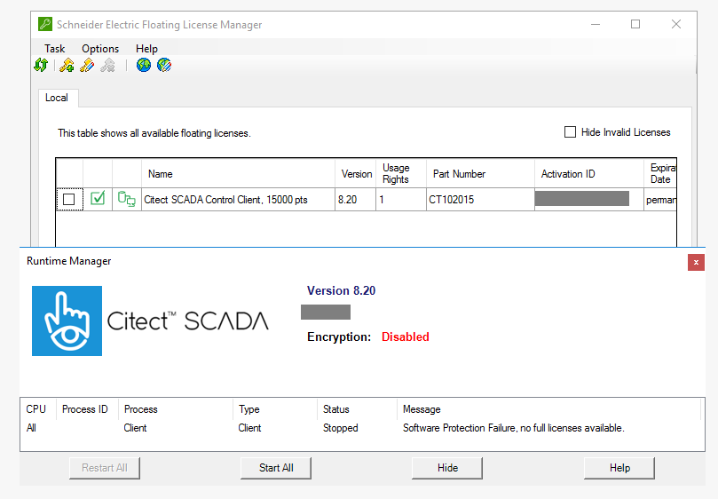

  • Dear Erik & Olivier,
    thank you for your information. I activated the Control Client licenses on the client computers without problems, but unfortunately the client closes immediately upon starting the SCADA system. Runtime Manager complains about Software protection failure (no full licenses available).
    This is strange because the server computers do not have any problems starting up their SCADA server & client processes. Do you have any suggestions to solve this problem?
    Below is a screenshot from the client.

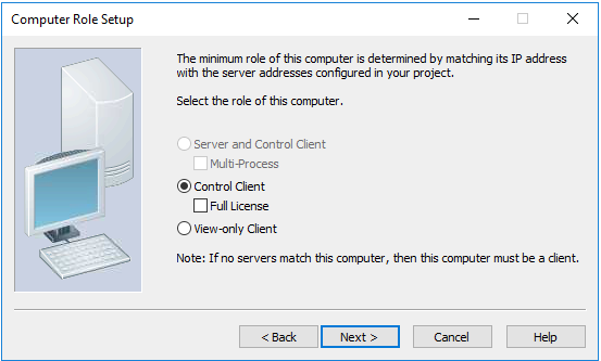

  • In the Project Editor make sure that you configure the Network Adress for your server as a real IP-adress or host name, NOT the loopback address 127.0.0.1 or localhost. Recompile if you made any changes.
    After compilation, please run the Computer Setup Wizard on all servers and clients and check the following:
    1. On the "Computer Role Setup" tab, make sure you select "Control Client" on your client machines.
    2. On the "Computer Role Setup" tab, make sure you uncheck "Full License" on your client machines.
    3. On the "Server Authentication" tab, make sure you enter the same password on all machines.
  • Thanks Patrick,
    I followed your instruction and managed to get the client working. Seems like unchecking the Full License checkbox solved the problem. Finally the Client starts up normally and I can operate the system through the client. What's the meaning of "Full License", anyway? What exactly is a "Full License Control Client"?
    Thanks for your help!
  • The checkbox tells the Client to use a full server license instead of a client license. This might be useful if you don't have a client license available (i.e. for testing purposes).
